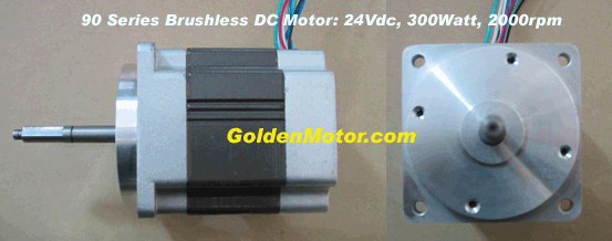

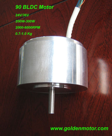

DC Brushless medium speed motor specification:
Model 38 series 45 series 70 series 90 series
Voltage (VDC) 12, 24 12, 24 24, 36 24, 36
Power (W)**
2-20 4-80 50-200 200-500
Torque (g*cm) 100-300 200-500 2500-6700 10000-250000
Speed (rpm) 2000-6000 2000-6000 2000-6000 2000-6000

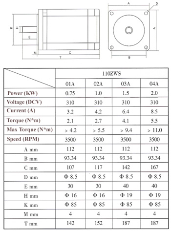

Motor performance curve   Dimensional Drawing
Click to view drawing

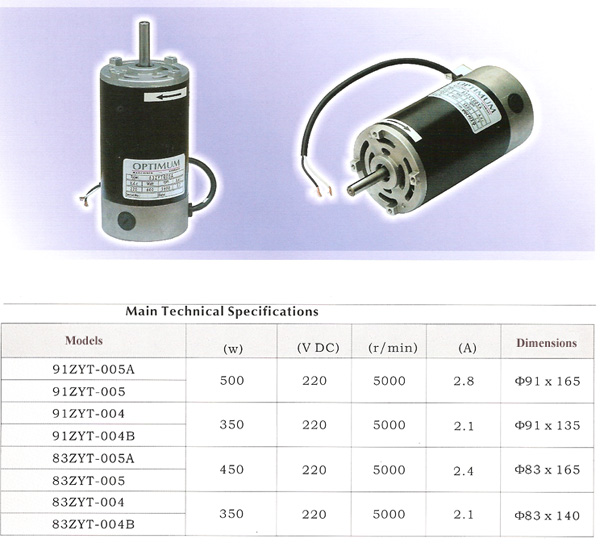

High Voltage Brushed Motors:
These high efficiency brushed DC motors are designed to use AC main power supply to drive your applications economically without costly AC/DC transformer.
