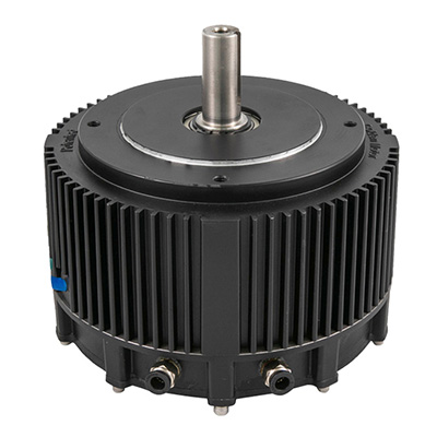

10KW Brushless Motor -- Double Power!

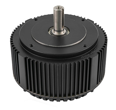

Model: HPM5000B -- High Power BLDC Motor
Voltage:24V/36V/48V/72V
Rated Power:3KW-7.5KW
Efficeincy: 91%
Speed: 2000-6000rpm (customizable)
Weight:11Kgs
Casing: Aluminium
Length (height): 126mm
Diameter: 206mm
Shaft: customizable
Features: Compact design,Water resistent, Stainless Steel Shaft, Self Cooling Fan
Applications: Electric car, electric motorcycle, electric tricycle, electric golf carts, fork lift, electric boat, etc.
Drawing(.pdf)   3D View
