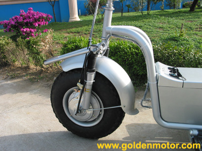

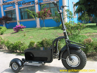

The new machine is a three-wheel buggy which you stand on like a scooter, with your golf bag strapped on ahead of you for easy access and a basket to take your accessories including drinks, waterproofs and scorecard. The three wheel all-terrain, stand on golf trolley is perfect for all golf users, young and old, and carries golf bags and players across all playing surfaces with comfort and ease. It's powered by a 750w brushless gearless electric hub motor and with its twist-grip or thumb throttle on the handlebars. Its unique folding design, combined with a detachable rear axle and battery packs, allows it to be neatly folded into the boot of a family hatchback. It has a range of 15-20 miles and can carry a total of 60kg plus its rider. It's simplicity itself to use; clip your golf bag onto the buggy, insert the ignition key, stand on the footplates, and you are ready to go. With a low centre of gravity design and wide track, the machine offers a stable and comfortable ride over even the most undulating of golf courses.
Specifications
  • - Motor Type: Electric Brushless Gearless Hub Motor
  • - Motor Output Power: 750 Watts (Performance Curve)
  • - Battery Type: 48v SLA or other types
  • - Battery Spec: 4 x 12 Volt 17 AH
  • - Battery Weight: 24 Kg
  • - Frame: Powder coated steel or chrome folding handle bars, folding footplates, detachable rear axle
  • - Max Speed: 10 Mph / 16 KMph
  • - Max Rider Weight: 110 Kg
  • - Max Golf Bag Load: 60 Kg
  • - Ground Pressure: 1.6 Kg/Sq cm (with 90 Kg rider & 20 Kg load)
  • - Hill Climbing: Max recommended 20% incline
  • - Brakes: Electronic Regenerative Braking System (Allows slow downhill descents)
  • - Charger: 240VAC or 120VAC Input - 48Vdc Output
  • - Controls: Ignition Key, Throttle, Battery Power Indicator
  • - Optional Accessories: Parking seat, Baby Seat, Umbrella Holder, ...
  • - Packaging: Gross Weight: 42 Kg (without batteries), Box Dimensions: 140cm x 37cm x 76cm
  • - Container Shipping Load: 72 units/20', 150 units/40', 175 units/40'H container

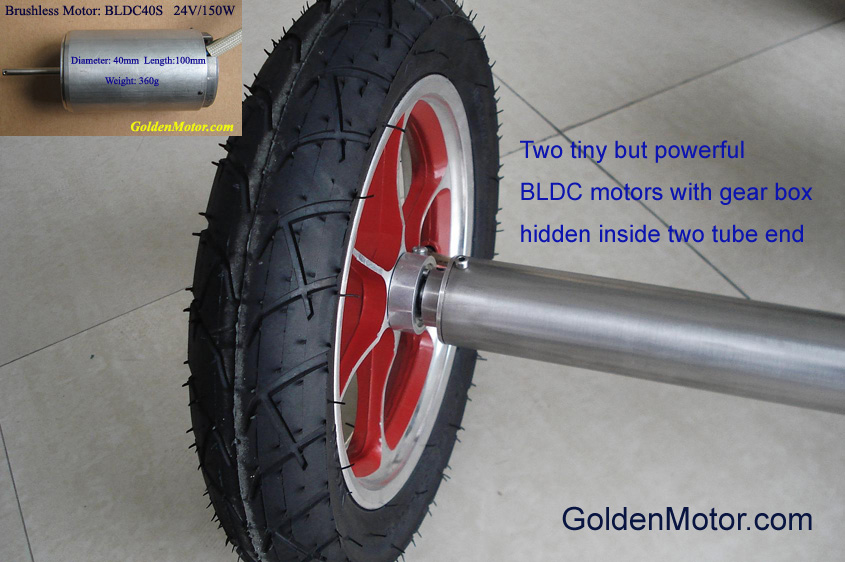

    This Golf Trolley Is Drived By Two BLDC40S
    Click to see motor performance curve
