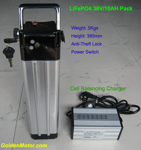

    LiFePO4 Battery Pack for e-Bikes
    Product Characteristics:
  • Non-toxic, non-contaminating
  • Small in size and light in weight
  • For all high power output applications
  • Can be used under extreme temperature
  • Extra long cycle life - 8 times life of Lead Acid and 3 times of NiMH
  • Extremely safe: no explosion, no fire under collision, over charged or short circuit
    Most Advanced Lithium Iron Phosphate Battery Pack with BMS and Charger
    Aluminium Casing with Switch/Key and Battery Level LEDs -- FREE!
    BMS and Self-cell-balancing Charger Included (Specifications) -- FREE!
    Weight: 4.5-5.5Kgs
    Capacity: 24V10AH or 36V/10AH
    Dimensions: 385x110x95mm
    Max Discharge Current: 35A
    Max Continuous Discharge Current: 20A
    Charging Cycles: >1000 times
    LFP-3610
    36V/10AH
    $339/set
    LFP-2410
    24V/10AH
    $288/set
    ...Credit cards via PayPal...
    Please provide your contact phone number for shipping company use!

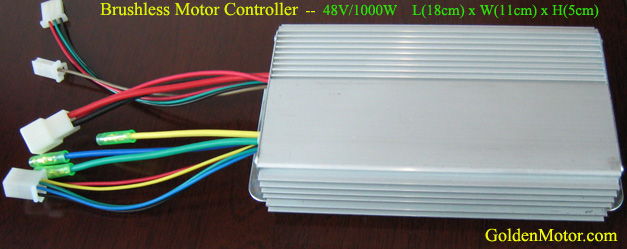

    Standard Brushless Motor Controller
  • Soft-start: make start-up smoothly
  • Excessive Current Protection
  • Low voltage Protection
  • BAC-0210
    36V/500W
    $48/set
    BAC-0211
    48V/1000W
    $58/set
    BAC-0212
    24V/300W
    $38/set
