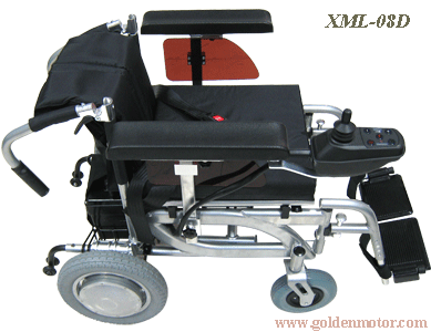

Specifications of Model: XML-08D
Foldable Power Wheelchairs -- eXtra Miles Series

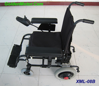

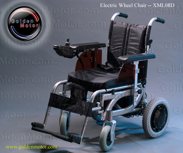

    Golden Motor Technology Co Ltd just launched its innovative power wheelchairs equiped with above mentioned pancake motors. They come with following unbeatable features:
  • Super integrated motorized wheel drive -- Make your wheelchair Simple, Neat and Light
  • Higher efficiency with our stamped pancake motor technology -- Drive you eXtra Miles
  • Double trip range: Up to 25Km with only 24V/20AH SLA pack (180x76x168mm - 12V20AH each)
  • Lowest power consumption: Less than 4Amps at speed of 4MPH at level
  • Two-motor combined output power: 400W/24V or 600W/36V with the same set of motors
  • Built-in electric-magnetic parking brake (EMB) and manual release handle
  • Climbing up and parking with 110Kg load at 12 degree slope easily
  • Lightest weight (30Kgs w/o battery, 44Kgs with battery)
  • Maintenance-free puncturable tyre
  • High load capacity (180kgs maximum)
  • State of art wheelchair joystick controller
  • Downloads: Motor Performance(PDF) : Wheel Dimensions(PDF) : Mounting Drawing(DWG)
    Test Video of XML-08D Power Wheelchair (13MB)

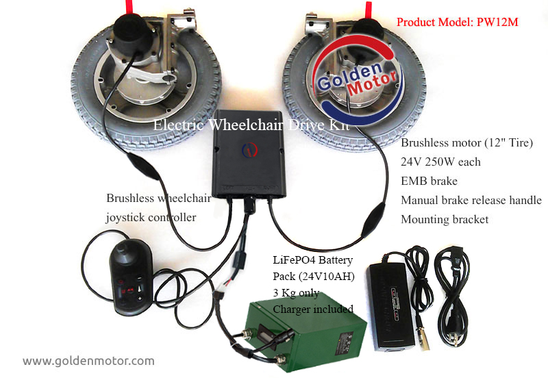

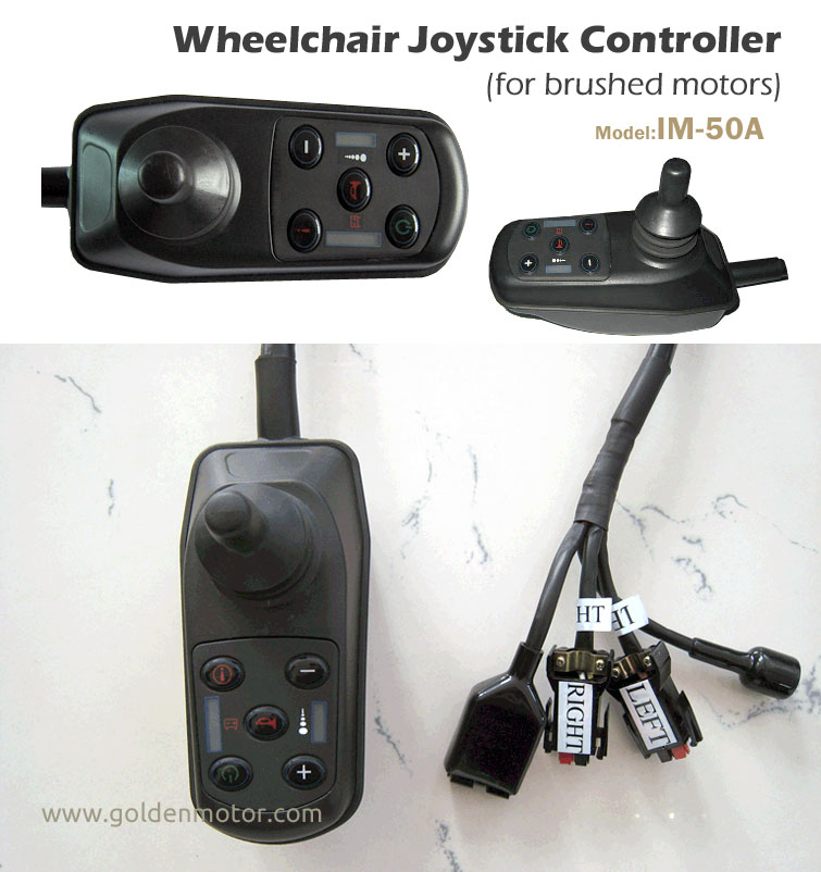

    Wheelchair Joystick Controller (for brushed motors)-- IM-50A
    Click Here to View Large Photo
    USD158 each (24V)
    This innovative, stylish wheelchair joystick controller allows you to move the e-chair in any direction smoothly and instantly with its user friendly control panel. It drives dual wheelchair motor intelligently by programmed microchip. You can really feel your fingers empowered with this state of art technology!
  • All-in-One, programmable Controller
  • 24Vdc/36Vdc, Maximum 50Amps
  • 5 Speed Settings
  • Regenerative Braking
  • Parking Brake Open Circuit Detection
  • Parking Brake Manual Release Microswitch Detection
  • Including all connectors to motors and charger
  • Exchangeable to other common joystick controllers
  • Online User Guide (PDF)

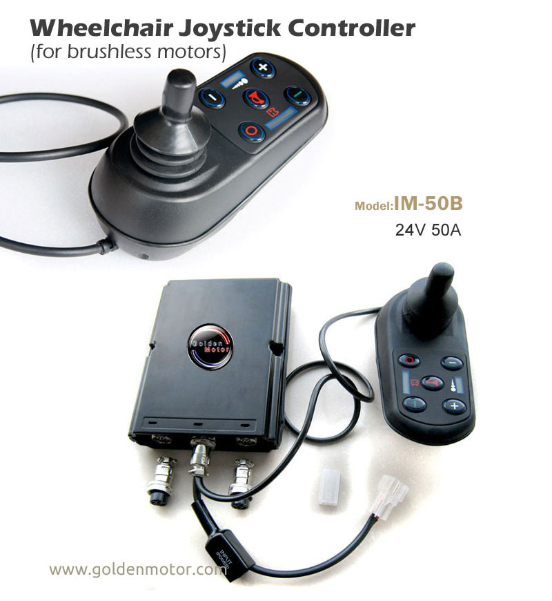

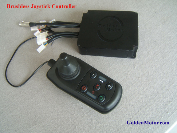

    Brushless Joystick Controller (for dual brushless motors) -- IM-50B
    USD255 each (24V)
    This unique joystick controller drives dual BRUSHLESS motors intelligently by programmed microchip. This extends your wheelchair life up to 10 times longer than current brushed motor powered wheelchairs in the market.
  • 24Vdc, Maximum 50Amps
  • 5 Speed Settings

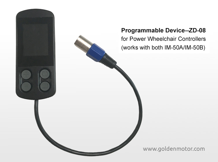

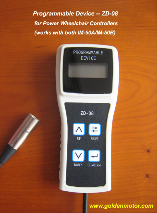

    Power Wheelchair Programmable Device -- ZD-08
    USD78 each
    This device is for OEM manufacturers or distributors to re-program power wheelchair controller parameters for special application needs. It is compatible for both IM-50A and IM-50B power wheelchair controllers.
    Programmable Parameters:
  • 1. Motor acceleration
  • 2. Motor deceleration
  • 3. Steering (turning) acceleration
  • 4. Turning deceleration
  • 5. Undervoltage value
  • 6. Reverse speed setting
  • 7. Maximum speed setting
  • 8. Reverse beep switch
  • 9. EMB brake switch
  • 10. Auto-shutdown timer

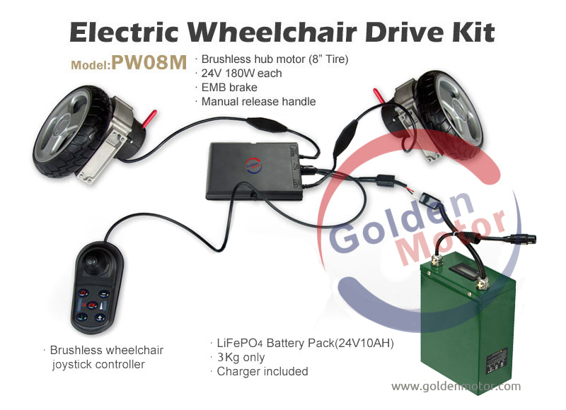

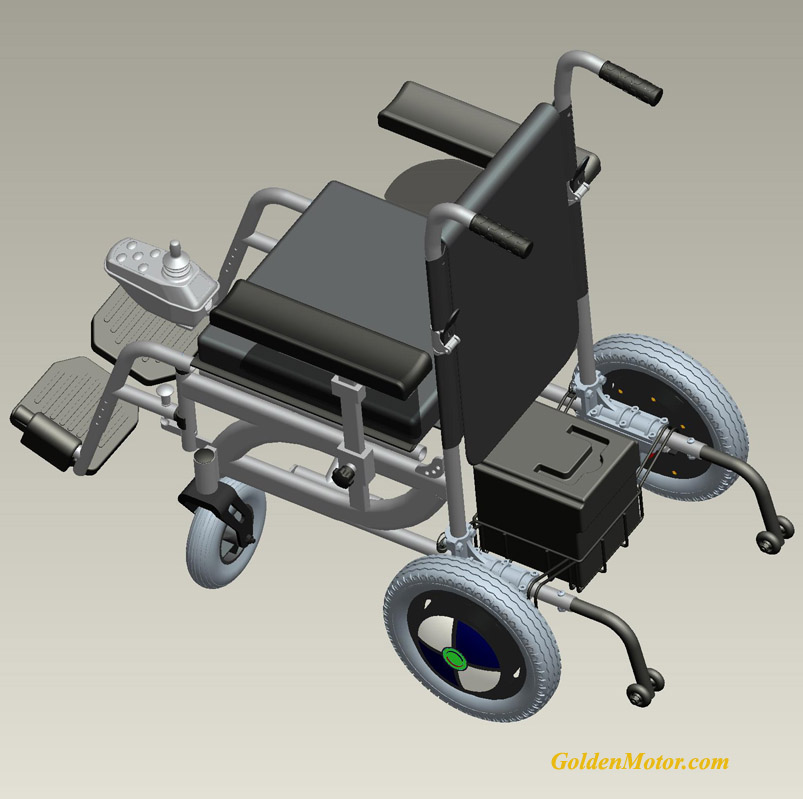

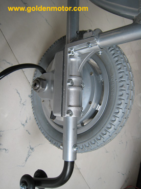

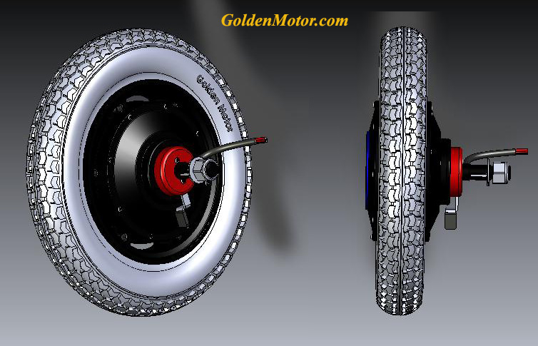

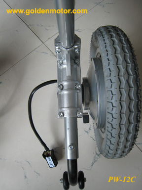

    Never being so easy to mount wheelchair motor like this one
    wheelchair motor, wheelchair hub motor, hub motor

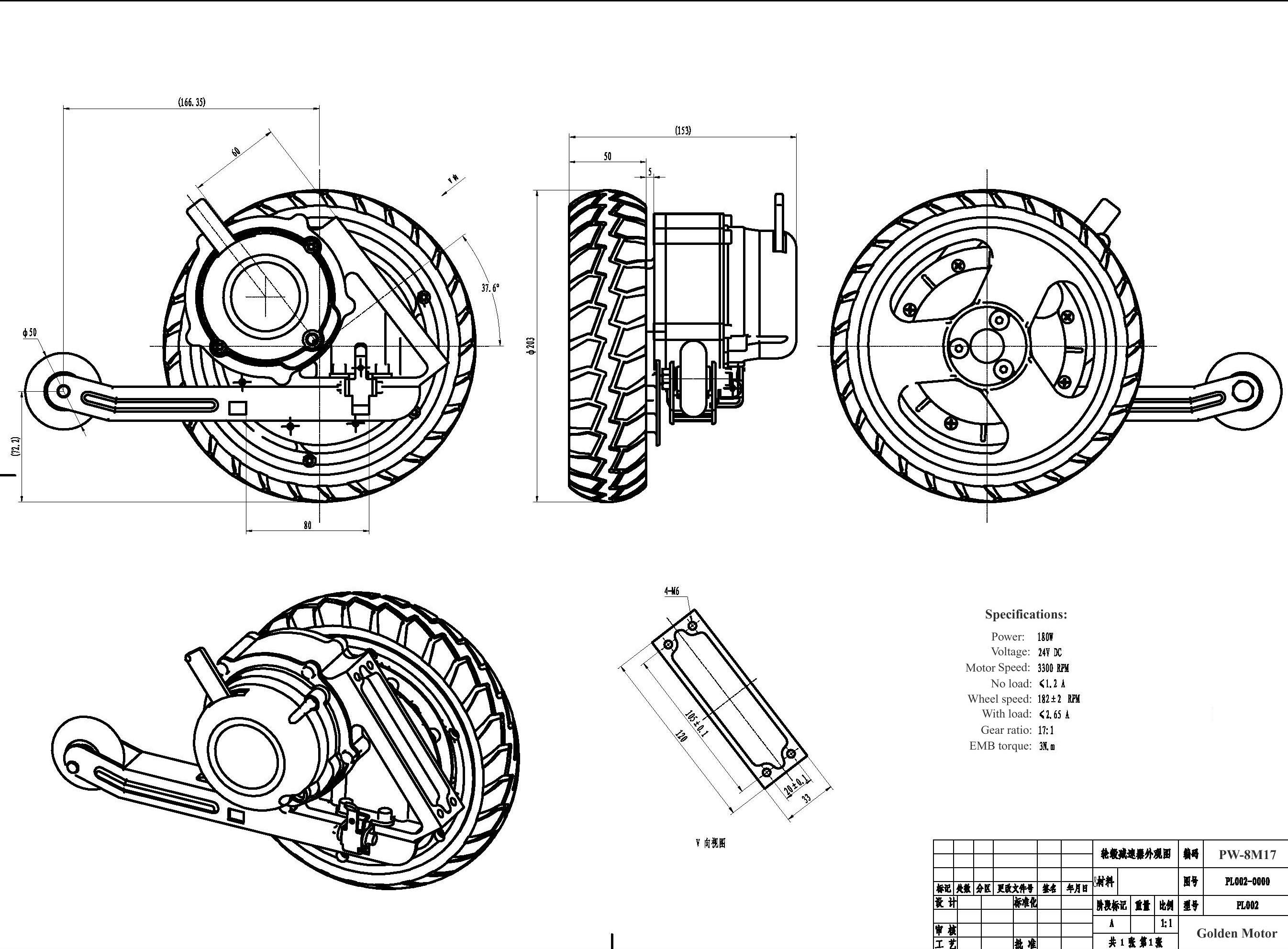

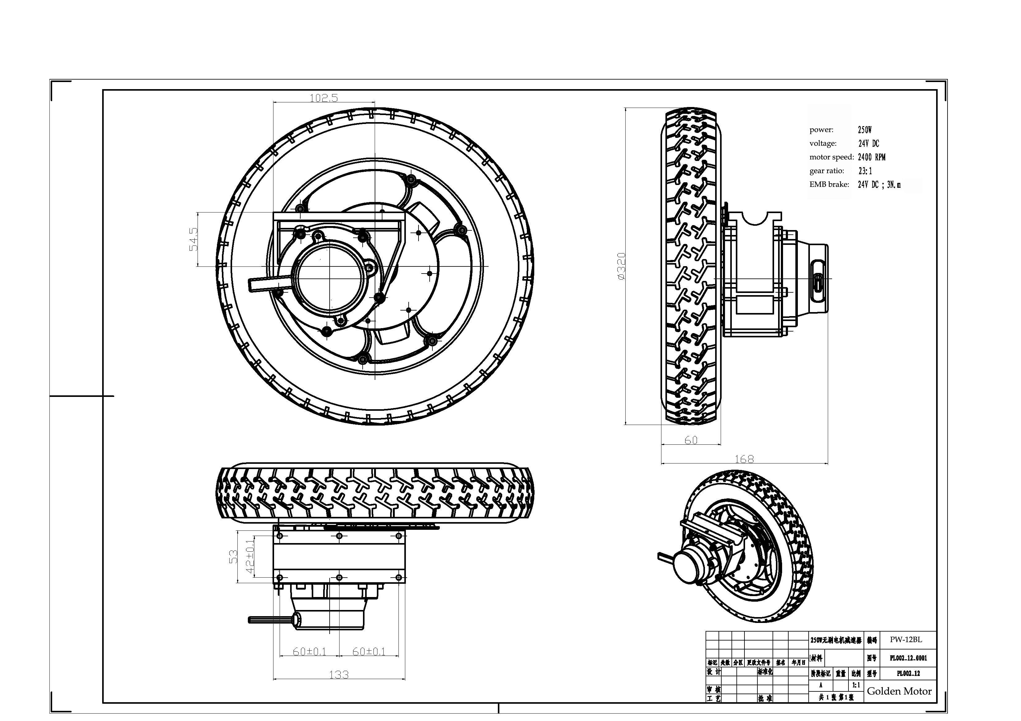

    Click To View Hub Motor Dimensional Drawing (PDF)
    Download 3D Drawing(SolidWorks Format) -- Download eDrawing to view (12.6Mb)
