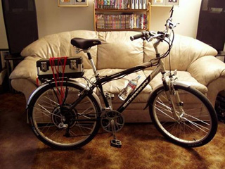

Photo Gallery of DIY e-Bikes/Trikes Contributed by GoldenMotor Riders

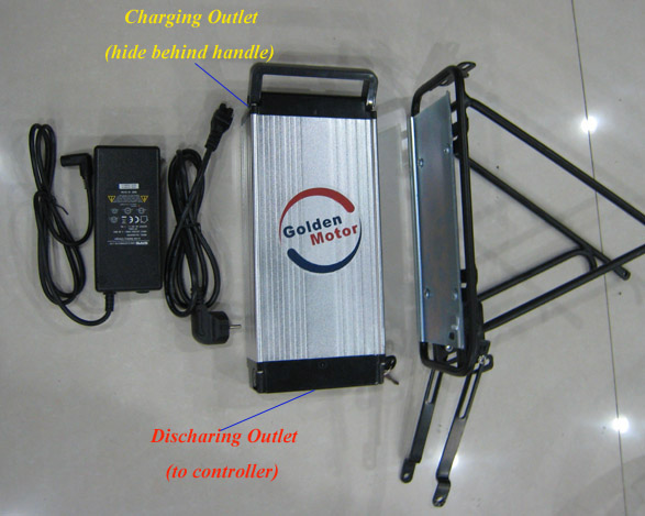

    Lithium Ion Battery Pack with BMS/Charger and Optional Sliding Rack
    Aluminium Casing with Switch/Key -- FREE!
    BMS and 110V-240Vac 2A Universal Charger Included
    Weight: 5.8Kgs
    Capacity: 36V/10AH or 36V/16AH
    Max Discharge Current: 35A(10AH)/60A(16AH)
    Max Continuous Discharge Current: 20A(10AH)/30A(16AH)
    Charging Cycles: >1000 times
    Ranges(full electric mode): 32Km(10AH) or 48Km(16AH)
    LFP-3610S

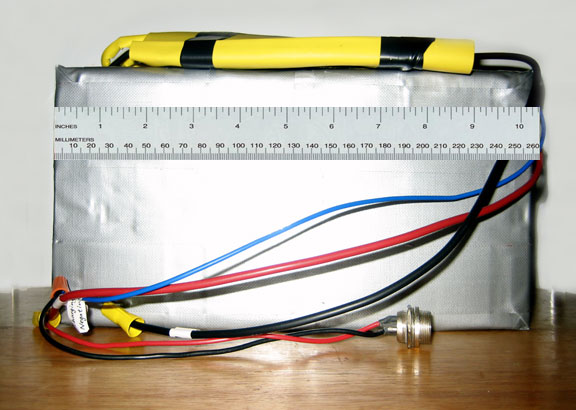

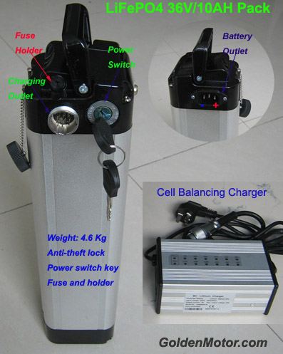

    Lithium Iron Phosphate Battery Pack with Cell-Balancing Charger
    Self-cell-balancing Charger Included (Specifications) -- FREE!
    Weight: 5.8Kgs
    Capacity: 36V/10AH
    Dimensions: 385x110x95mm

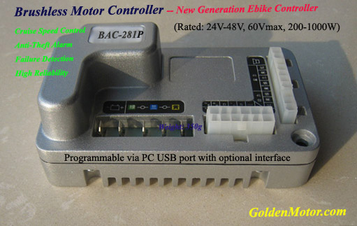

    New Generation Controller -- Technology Breaking Through!
    Magic! ... It can drive your ebike even with failed motor hall sensors, throttle, breaker, or all of them failed together!
    Wiring Diagram(.pdf)
    Wiring Diagram(.pdf)    (.jpg)    (3D View) -- Download eDrawing to view (12.6Mb)
    Special Features:
  • Cruise Speed Control
  • Motor hall sensor failure redundency (Automatically switch to sensorless control)
  • Anti-theft alarm and wheel-locking by detection of vibration
  • Other failures redundency (Work with failed throttle and power breaker)
  • You can force it to work with lower voltages (e.g 48V to 36V, 36V to 24V)
  • Report failure components by beeps
  • Motor phase self detection and calibration
  • Support Forward and Reverse Control
  • Excessive Current Protection
  • Low Voltage Protection
  • High Reliability
  • Available for 24V,36V and 48V brushless motors
  • Buy Sample(wholesale prices negotiable)

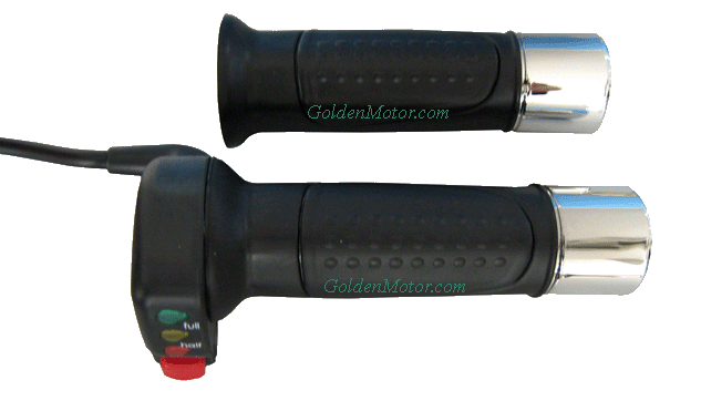

    Integrated Thumb Throttle With Battery Gauge
    BAC-0100
    36V
    $12/set
    BAC-0101
    48V
    $15/set

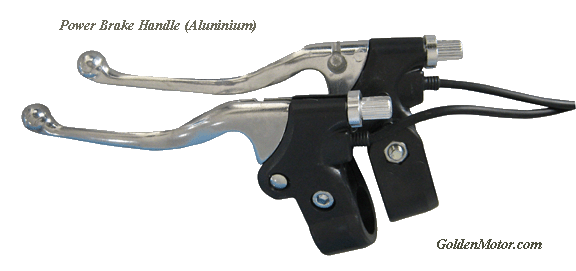

    Power Brake Handles
    BAC-0601
    $12/set
